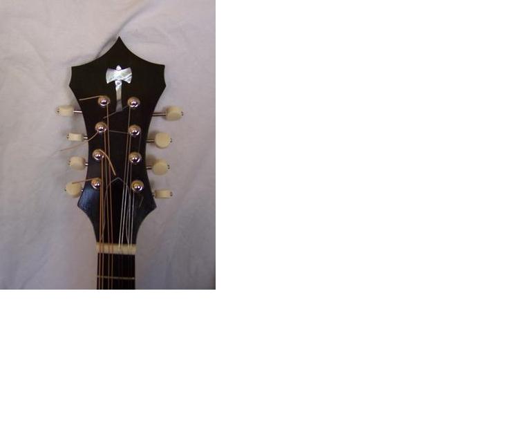

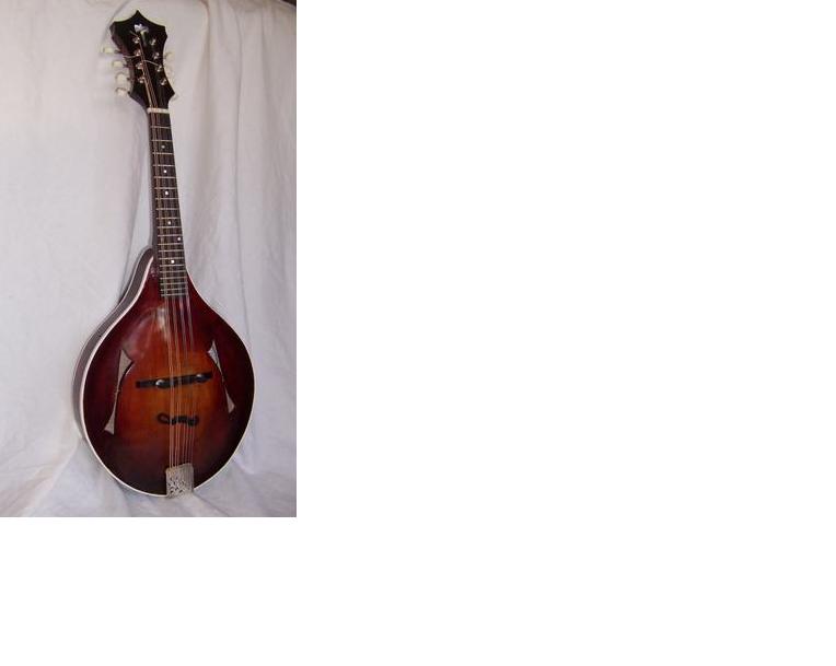

My name is Geoff Burghardt, I'm new to the group here. I wanted to share my latest mandolin with you all. It is my 10th, and was done for Red Rocks Community College in Lakewood Colorado where I will be teaching mandolin building starting in the fall. I am looking forward to learning and sharing a lot here. Thanks for having me

Welcome to the forum! I don't know much about mandolins but know one thing....it sure looks REAL nice
PostPosted: Sat May 06, 2006 11:44 pm
Hi Geoff
Welcome to the forum. I'm sure you will enjoy it here. Very nice mando.
PostPosted: Sat May 06, 2006 11:45 pm
Welcome Geoff, Nice to have you here. VERY nice mandolin! I like the dark finish and your headstock inlay.
PostPosted: Sun May 07, 2006 12:44 am
Welcome, and beautiful work.

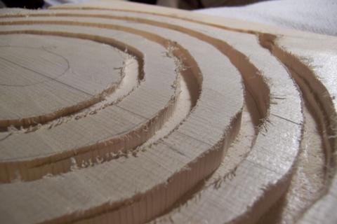

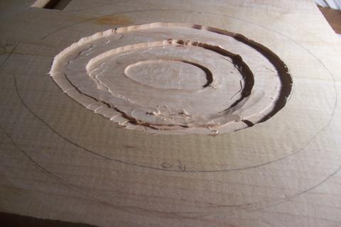

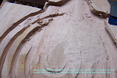

I think good planning is the best way to do anything. I do it like this:
Draw concentric circles from the outside edge of the top or back (I usually call them plates at this stage, not sure how correct that is) about 1" apart until you get to the center. These circles, or ovals depending on your body shape, will be lines of equal depth while you carve. Now select the profile of the arch you want on your top and back (usually about the same, except for near the heel)(I use a drawing from the back of Siminoff's book) and figure out how far down each of these equal depth lines is based on the profile of the arch, from the top of the wood. Now rout along the lines a consistent depth, getting deeper near the edges, and deepest about 3/4 - 1" in from the edge of the rim on the outside, and deepest in the middle getting shallower toward the edges on the inside. Let me read that to make sure it makes sense. Maybe a picture will be better
If you have more questions I'd be happy to help. Good luck!
PostPosted: Sun May 07, 2006 3:12 am
Joined: Thu Apr 27, 2006 12:56 am
Posts: 77
I forgot to add that once you have it all routed, the carving is just connecting the lines. I have a #5 sweep 1" gouge and a mallet that does most of the dirty work, then I smooth that back with a wider sweep gouge. then once you've connected the lines, come in with a light touch on the chisel or a small convex plane and get your graduations. Then scrape like a banshee. That's the way I do it, I know there are many variations and some of those may be easier or harder. One thing I can say, this is a lot easier than doing it completely by hand (which I do recommend trying at least once).
